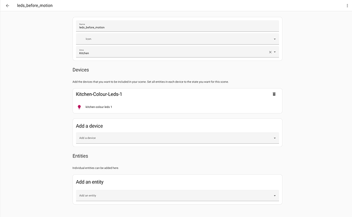

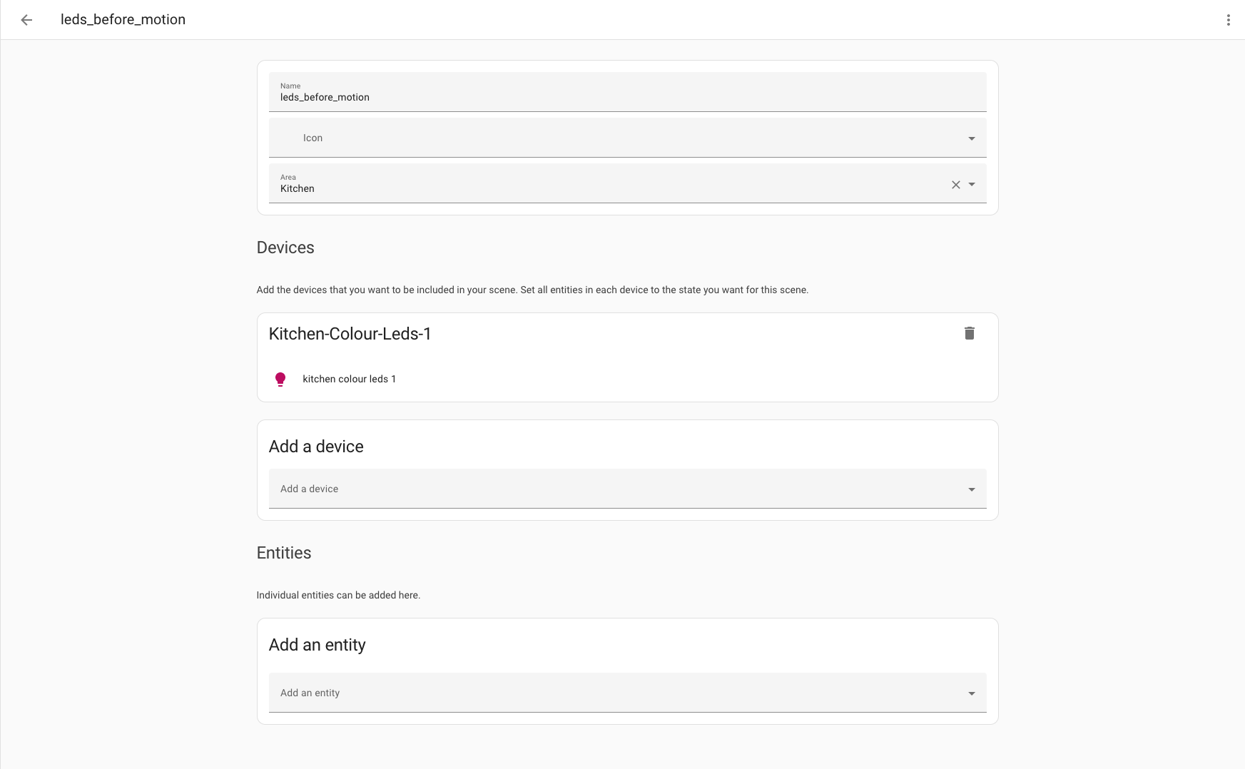

Scene to put the snapshot into and to be reloaded from after NO motion.
Automation to reload the snapshot from the above scene.
alias: kitchen leds reload
description: ""
triggers:
  - type: no_motion
    device_id: 55e691e9b1cb092f850de53663eb780c
    entity_id: ef1867600fa68c4a2acc25f499e294fb
    domain: binary_sensor
    trigger: device
conditions: []
actions:
  - action: scene.turn_on
    data: {}
      entity_id: scene.leds_before_motion
mode: restart

Automation to capture leds state when motion is detected;
alias: kitchen leds catch
description: ""
triggers:
  - type: motion
    trigger: device
conditions: []
actions:
  - data:
      scene_id: leds_before_motion
      snapshot_entities:
        - light.kitchen_colour_leds_1
    action: scene.create
  - data:
      kelvin: 6500
      brightness: 255
      entity_id:
    action: light.turn_on
mode: restart
Scene Created;
Automation to reload the previous leds state after no motion detected;
description: ""
triggers:
  - type: no_motion
    trigger: device
conditions: []
actions:
    data: {}
mode: restart
Sometimes instead of full 6500k when motion is detected the leds stay in the slow rainbow effect, but at full brightness.
Sometimes the full 6500k comes on when motion is detected, but then when no motion the LEDS instead of reloading the previous state (slow rainbow), just go to RED and stay red. The scene isn’t reloaded.
I’ve restart and tried many things. I haven’t used this or had the kitchen LEDS switched On since last winter, and this used to work back then. I only use this during the winter months.
Can somebody please offer some assistance with this?
I’d be so grateful for some help.
