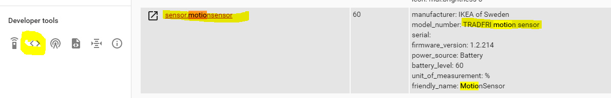

Maybe I’m stupid, but since when do we support tradfri motion sensors as entities? I only get the battery level…
That is great!! … But will the Motion sensor not trigger the off when it is already turned on if nothing is set in the OFF automation?
