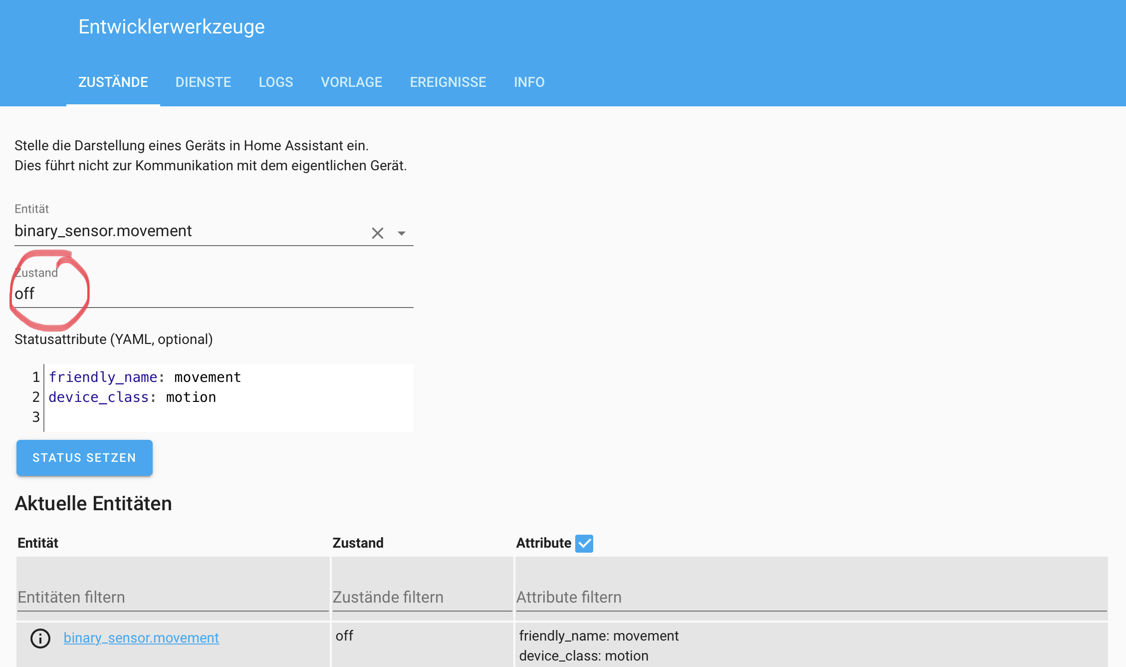

At the developer site I can change the state of the binary switch manually.
Now what I am trying to do is to change the state via api.
