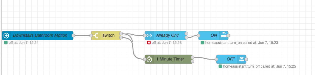

Hi guys. I am trying to automate my guest bathroom to when it detects movement, it turns the light on immediately. I also want it to turn the bathroom fan on when it keeps detecting movement after 3 minutes and the bathroom fan and light should turn off after it doesn’t detect any movement.
I am new to NodeRed and this is what I was able to accomplish. The light turns off automatically after a minute even if it keeps detecting movement. How can I make this work? If you have a code please share.
This can get real complicated. Howver to fix your light off problem… remove the wire from the switch on to the 1min timer…
only need to start that timer when the movement is ‘off’.

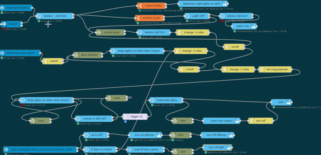

Alot going on:
motion sensor. door sensor, a second door sensor on toliet, and a oil diffuser when the toliet flushes…:
