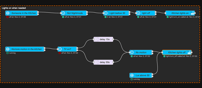

If you use the trigger node instead of the timer mode you can retrigger when a new message arrives or send msg.reset to cancel the timer completely

This seems to work perfectly! Thank you! :slight_smile:
Disclaimer: it didn’t work at first because I also had another really dumb error. The check if the lux is above a number and then always turn the light off actually was set as LOWER (copy/paste and never fixed it it seems). So the light actually turned off when it became dark :slight_smile:
