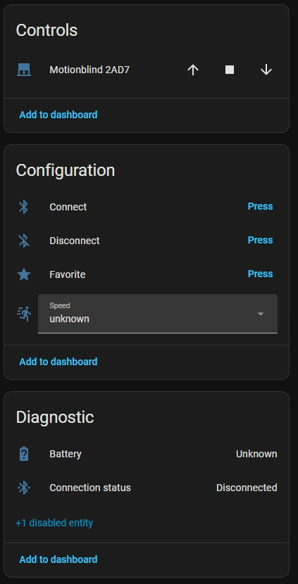

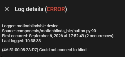

Also, I’m currently unable to control the first unit through HA. Even though I can see the device, I get the following error message when I click “Connect”:
I’m using an ESP32 with an external antenna running ESPHome to receive Bluetooth, and that seems to be working fine since the first unit was discovered. However, the receiver is quite far away from the blinds, so I may need to add another one.
