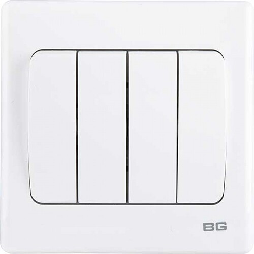

To give you an idea what I’m aiming for, consider the following example switch:
While the image above contains 4 dumb switches, I hope that it conveys what I’m looking for, i.e. a mount or switch that allows me to keep the functionality of my two dumb switches, while simultaneously adding two digital switches that can by tied to a HA automation or light.

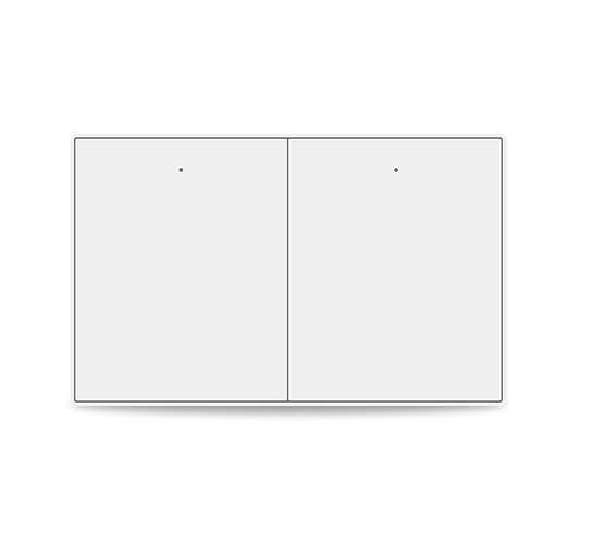

@TH3xR34P3R thank you. I don’t mind taking of and replacing the current switches. If I replace them with the following product (i.e. the switch that you linked, but the 4 gang version):
Would 2 of the switches be able to control the dumb lights, and the other 2 my HA automations?
My apologies for overcomplicating my question, I haven’t worked with smart switches before (only relais, e.g. the Sonoff ZBMINI-L2) hence my confusion.
It’s why we are here making sure its simplified based on our experience and yes the switch is added as a single device when paired to HA so you just wire in the lights to 2 of the buttons then use the other two as triggers for your automations.
