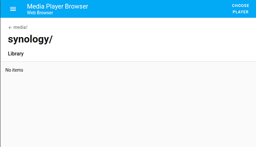

However in Home Assistant web I can only see the local files:

Does this mean I cannot access files that are mounted?
