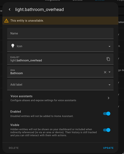

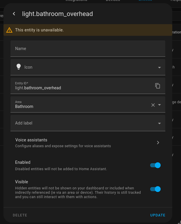

I am trying to follow this process, but I am stuck at “delete restored entities from the entities list”
Where are the “restored entities”?
After I deleted the yaml entities, I restarted, yet I still see the old entities in my entity list (with platform Switch). The option to delete them is disabled.
Here is a screenshot of the yaml entity I deleted:
