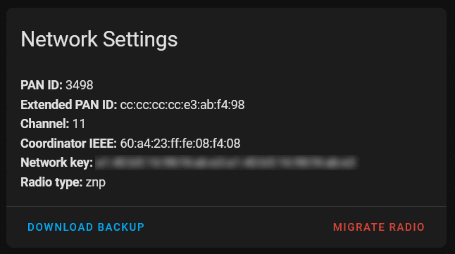

Now you should see a new screen with the options to download a backup or migrate the radio. Now is a good time to actually download a backup to be on the safe side. Once that is done you can click the migrate radio button and confirm the warning.

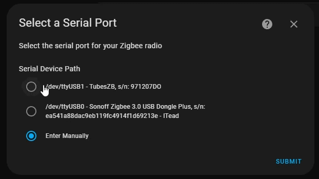

In the following screen you are asked to select the new radio. Chose the right name and the path from above (ttyUSB1 in my case) here and click submit. ZHA will now attempt to restore a backup onto this new coordinator which might take a moment.

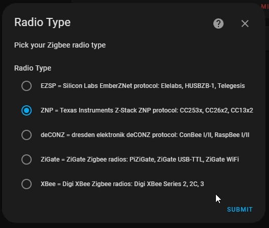

Next you have to select the type of radio. This depends on your hardware of course but for the Sonoff dongle Plus znp is the right choice. For Sonoff Dongle E choose EZSP.Click submit again to continue.

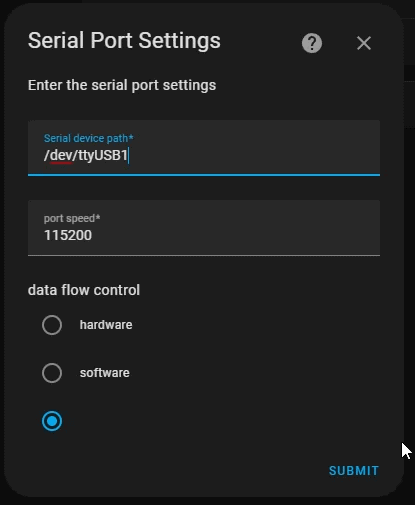

Then its finally time to enter the serial device path. Choose the /dev/serial/by-id/... . The port speed of course depends on your hardware again but 115200 should be fine in most cases. Data flow control can be left on default. Now one more click on submit.

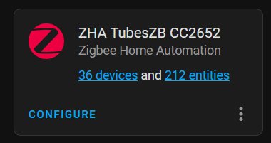

So i did the migration now. and it failed!
1.) I plugged in the new dongle and it was found by the os (dmesg and lsusb/usb-devices listed the dongle). It is attached to /dev/ttyUSB0. In my docker-compose I have the device listed to be visible within docker. So I thought all is fine. I started the migration by pressing the button, but it could not see the new sonoff dongle. I needed to restart the container first, to let the container see the dongle. So that was not a big issue. But the old dongle was already resetted by the integration.
2.) I tried it again, after the container restart. Now it found the new dongle and started the migration. Now it failed telling me: zigpy.exceptions.NetworkSettingsInconsistent: Radio network settings are not compatible with most recent backup! I thought this has todo with the sonoff beeing incompatible with the conbee II as it is using another protocol and a can handle zigbee version 3. It also changed the channel from 15 to 25! Could also be a problem, right?

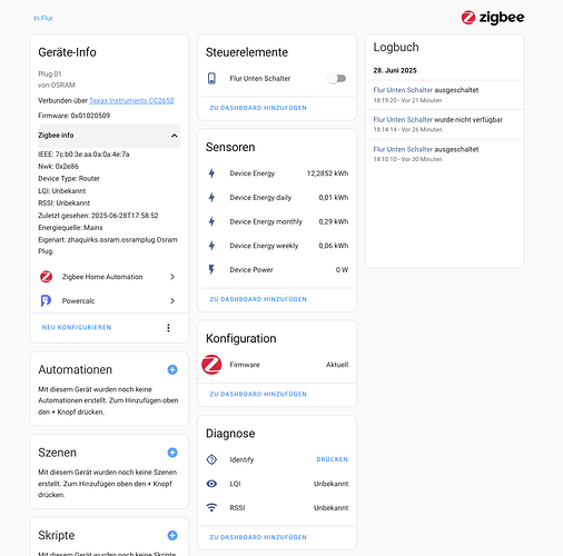

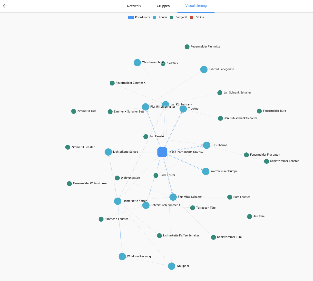

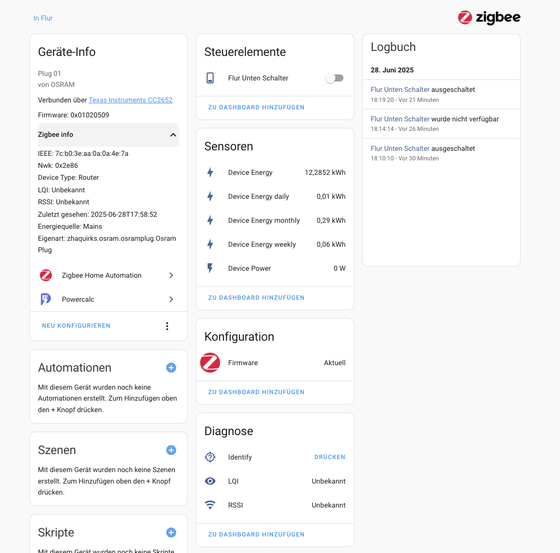

3.) I now tried it a 3rd time by inserting the backup instead of keeping the existing network. But now all paired devices are showing no RSSI and are not responsive any longer. So it seems that I am in the worst case scenario. Even after another 30 mins, not a single device has an RSSI value, but all seem to be visible in the network:
Just tried it again using the newly downloaded backup, now it worked. All devices are coming back to be responsive. Only thing I am wondering is the RSSI parameter, which is still “unknown”, for each and every device.
