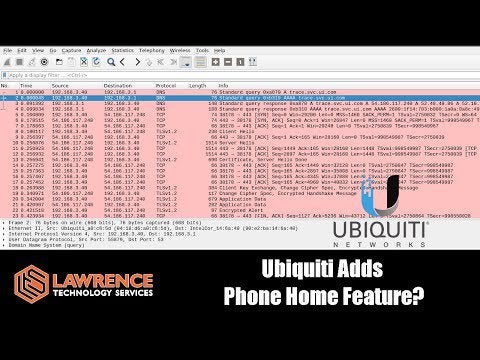

Just be aware of this:
Quick fix; block the following urls in pihole:
trace.svc.ui.com
ping.ui.com
