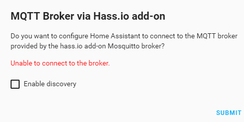

Hi all new to home assistant. i’m having a problem trying to get MQTT working on home assistant using the addon. i keep getting the below error
mqtt
i have reinstalled home assistant and tried configuring on a fresh install but same error
i can see on the broker logs on HA that my sensor is connected fine
Hoping you guys can advise me what i am doing wrong
