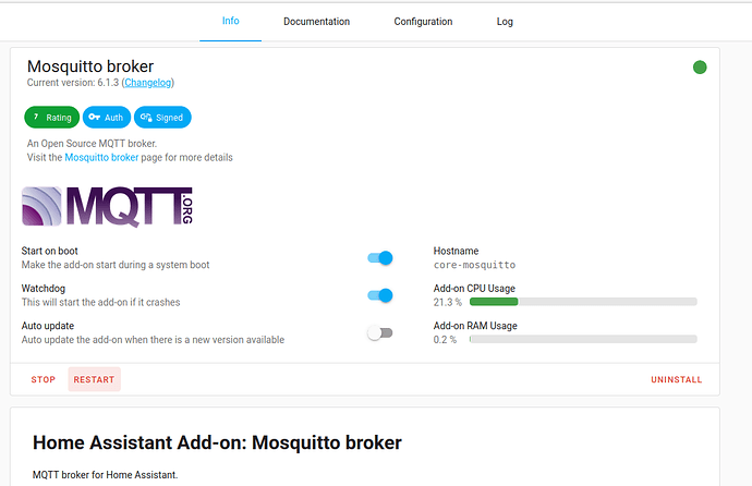

It seems like the MQTT addon isn’t starting correctly on system boot?
Although it looks like its running in the Addon, it apparently isn’t:
But oddly, if I simply click “Restart” on the MQTT Broker addon it magically all works again?
And then all my errors are gone and sensors magically appear?
