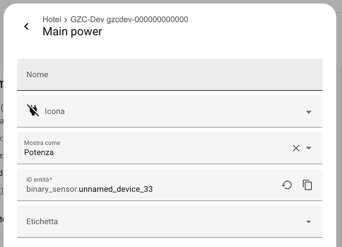

And this is the first entity:
As you could see, it displays - as entity_id - the value “binary_sensor.unnamed_device_33”. The same thing if i use the new “default_entity_id” or node.
Suggestions? We need predictable entity_id to be used inside our custom cards, and not such kind of names.
