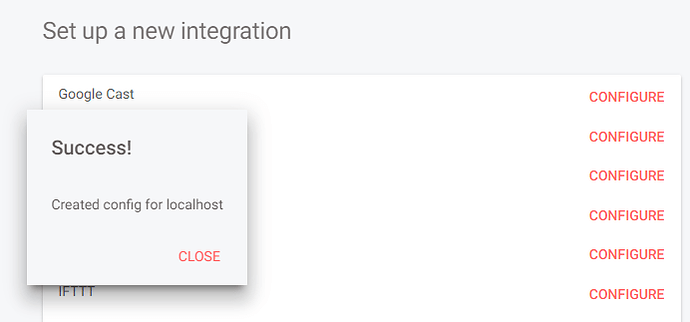

OK… So I have the new MQTT add-on and I have set up a user in HA for MQTT, reset the addon options to defaults and configured the integration on IP 127.0.0.1, port 1883, and the username and password for the newly created user. I also checked the box to enable MQTT discovery. Finally, as per instructions, I deleted the entire mqtt section on configuration.yaml including the mqtt: key/line.
The username and password are identical to the old user/pass I had configured already in Tasmota on my Sonoffs.
This all worked perfectly. I did delete the old integration and restarted HA before adding the new MQTT integration and configuring as per above.

I removed MQTT from my configuration.yaml and removed all devices from binary_sensor.yaml and tried the integration and checked discover. Got a Success! response. Clicked on the MQTT inside the configuration settings page and it says, “No devices configured”
