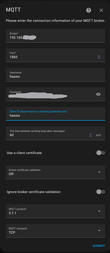

Here are the settings for the MQTT Integration:
To troubleshoot it a bit I added a Ping Sensor in Hassio, which pings the EMQX IP and it stays connected all the time, so there shouldn’t be a network issue (as the EMQX log may show, too).
Since there are already multiple shellies and a zigbee2mqtt-container connected to EMQX I think the configuration is fine.
