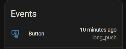

I finally got a glimmer of understanding when I found this snippet on the event docs:
So, the solution is looking at the entity which was created when you defined the “event”, e.g.:
- event:
    unique_id: "shelly_switch_keuken_switch_licht_event"
    device_class: "button"
    device: {
      identifiers: "shelly_switch_keuken",
    qos: 2
    state_topic: "shellies/shelly_switch_keuken/events/rpc"
    value_template: |
      { {% for element in value_json.params.events %}
      {% if element.component == "input:0" %}
      "event_type": "{{ element.event }}"
      {% endif %}
      {% endfor %} }
    event_types:
      - single_push
      - double_push
      - long_push
This leads to the following entity appearing in hass:
The “state” of this entity is the timestamp of the most recently received message. Any time an event is received, there’ll be a “state” change - because of course the timestamp changed. You can use this as your trigger.
Then, in the automation, you can filter on the type of event if necessary:
Hope it helps someone :slight_smile:
So the solution is to simply just do a state trigger on the event entity? Thanks! That’s not obvious at all from the docs.
