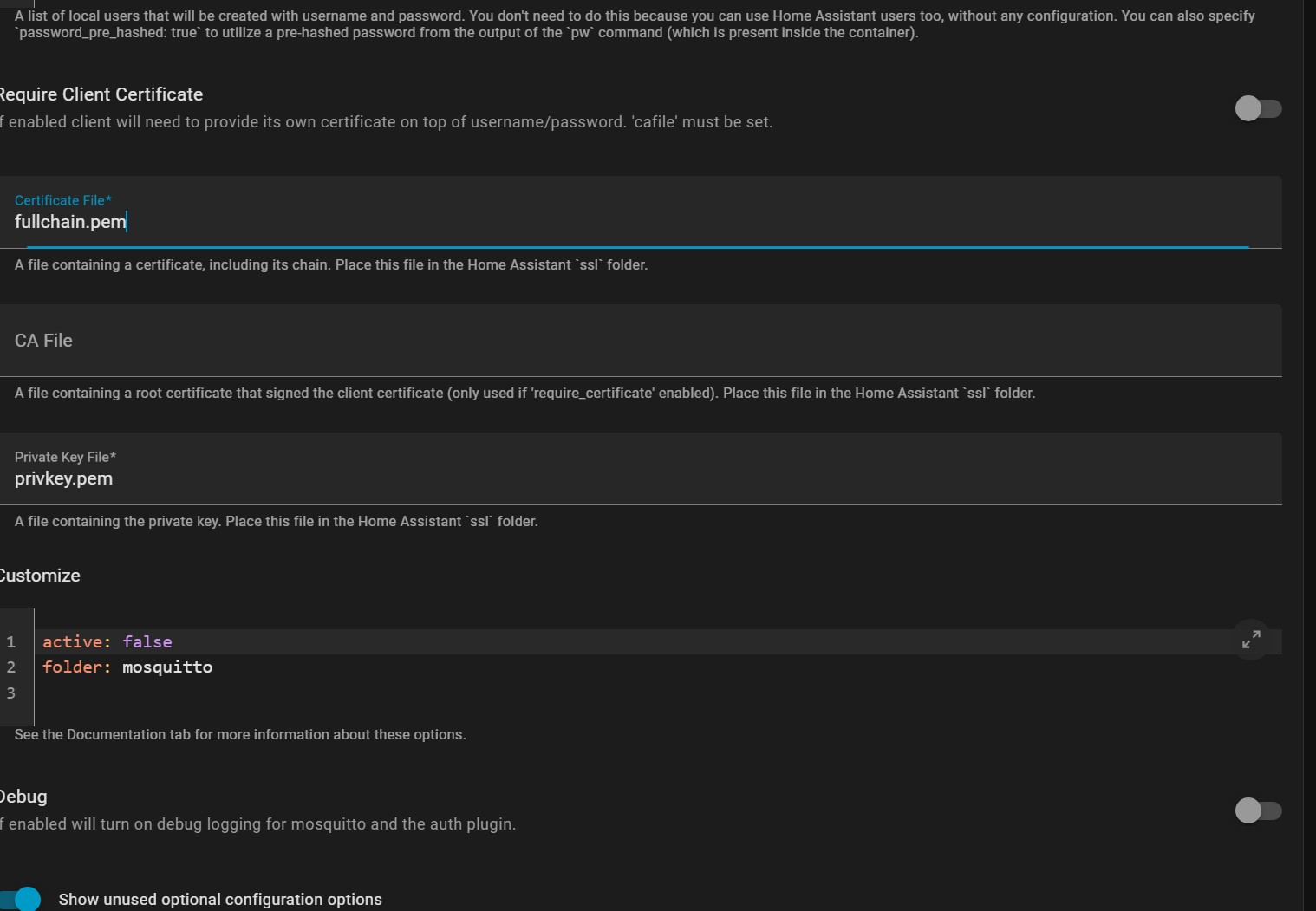

You’ll add the broker info in the Govee to MQTT add-on. On the configuration tab, click the boolean switch that says “Show unused optional configuration options”.
I don’t have the option to add the broker info.
That’s the mosquitto broker configuration. Not that one! lol
Go into the configuration tab for the Govee to MQTT add-on
Found it, thanks. But nothing changed…

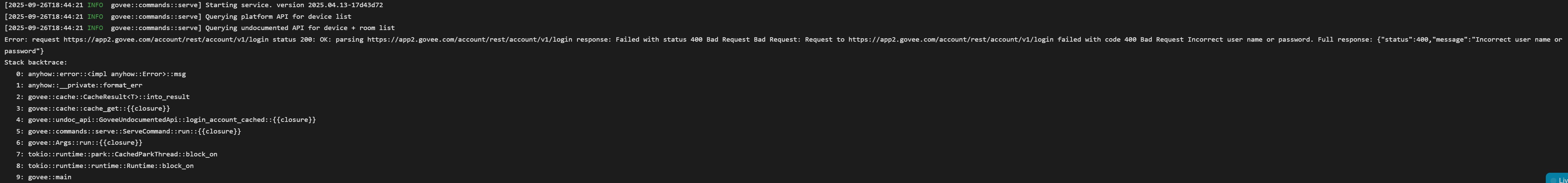

In Govee to MQTT Bridge log I see this error.
But I double-checked and login details are correct.

Well the error in your screenshot says incorrect Govee username or password. Quadruple check it. Make sure you don’t have caps lock on.
I have logged out of the app, used “forgot password” and received an email from Govee. I changed my password and no the error says that it failed for legal reasons and email isn’t registered yet. Which is weird because I receive emails from Govee.
I also tried to sign up a new account at Govee - Haciendo la vida más inteligente | Govee Spain and used another email address. Received confirmation an can log in at the website.
Used email and psswrd in HA and same error.

Am searching now to see how I can bypass that Error 451.
Here you go. This should work Can't get the login to work? · Issue #239 · wez/govee2mqtt · GitHub
I tried exactly the same thing earlier today (as I wrote before) but it didn’t give any result… but now it works.
