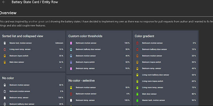

Battery StateCard
Battery state cards, deliver it all with much much less codes
And With “Autoentities” or conditional cards ( are even other card options ) then you can “specify” which entities/sensors you specifically want included
