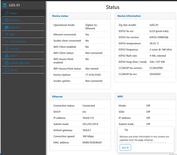

Nathan and Chris, thanks a lot! Do standalone Zigbee controllers have a web UI for configuration and firmware updates? How do I assign the IP address to use, how do I flash the firmware, how do I choose the channel to use etc.?
Web server is limited, old tubezb
UZG1 has more options
Francis, thanks! When comparing these two interfaces I’m very much drawn towards the UZG-01. I noticed it still uses the CC2652 (Texas Instruments) chipset, so I assume a version with the EFR32MG21 (Silicon Labs) might be released soon. From what I’ve read, the EFR32MG21 is a newer, more performant and future-proof chipset.
