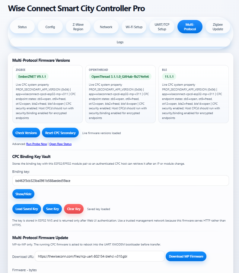

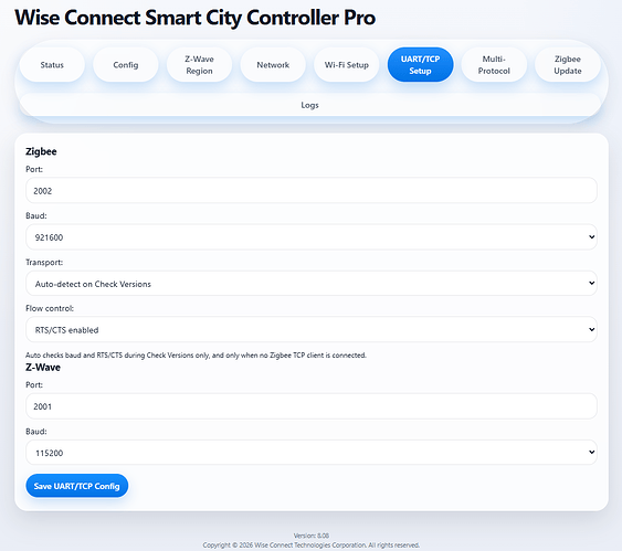

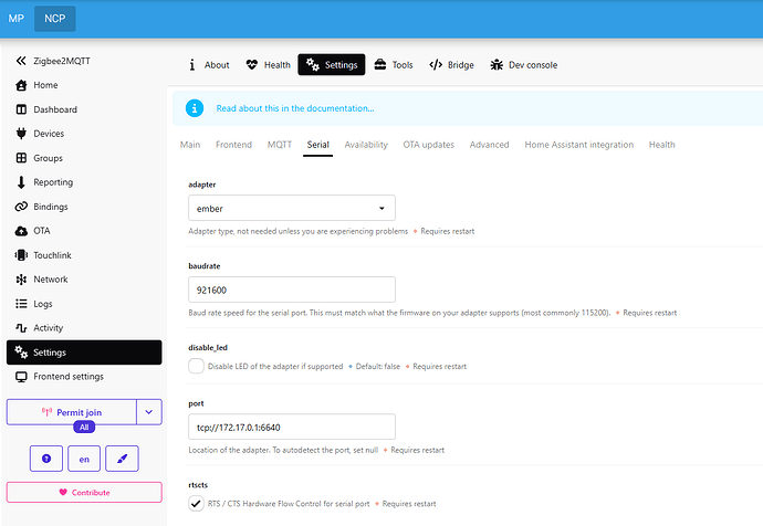

Just redesigned the multi-protocol radio module with UART baud rate 921600. Because at 921600 b/s, it needs hardware flow control. Over 24 hours testing, the connection is very reliable thanks to flow control and DMA.
