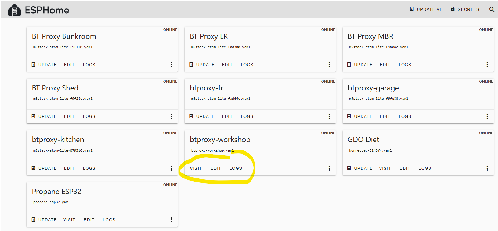

Does ā€œUpdate Allā€ work at all? I have about 12 devices, all of which are online. On my instance, update all only does one device. Am I missing something?
OK, I updated ESP Home to the latest version (2025.7.4) a little while ago. My 10 ESP devices are all online and can be updated wirelessly.
When I select ā€œUPDATE ALL,ā€ one device gets updated and then the update process appears to just stop.
When I select ā€œUPDATE ALLā€ again, another device gets updated and then the process stops again.
Is the UPDATE ALL menu supposed to update all ESP devices? I assumed this is what it was intended for. If so, it appears there is a bug of some sort. If not, what is its purpose?
I believe it’s supposed to, but it might only work properly for ESP8266.

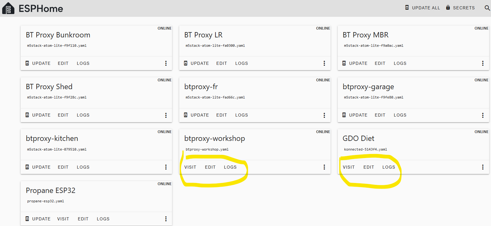

I noticed some other wonky behavior. I moved one of my bluetooth proxies from one room to another, so I used the Edit menu to change the friendly name from BT Proxy Bunkroom to BT Proxy Em Bedroom. When I selected ā€œSaveā€ the friendly name changed correctly but the ā€œUPDATEā€ menu for that device disappeared. This was prior to updating that particular ESP to the latest version.
As an experiment, I then selected ā€œEDITā€ on the BT Proxy LR device and without changing anything simply hit ā€œSAVEā€ - same result. The Update menu vanished as if that device had been updated.

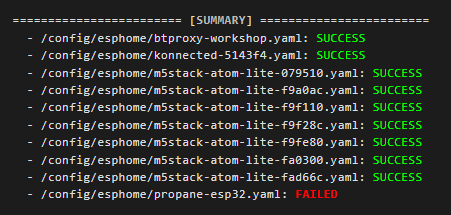

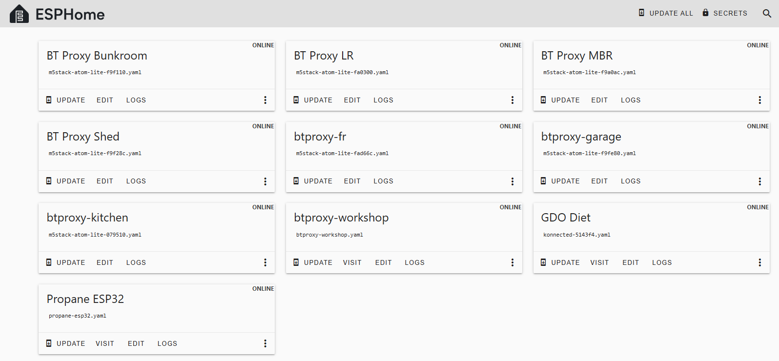

Next, I selected the ā€œUPDATE ALLā€ menu once again, and this time, all of the devices updated! This is the first time it has worked after having done at least a half dozen ESP Home updates.
Although it says the last device failed, it seems to have updated since it shows the same ESP version when selecting the VALIDATE menu. Also, the dashboard card for that device shows the correct Propane level. This is the only ESP device I am using that has Arduino code installed on it. Maybe that’s why.
Makes no sense at all. The next time an ESP Home update comes out (seems like there has been one every week lately), I will see if I can repeat the behavior. If all it takes is a quick EDIT and SAVE of one device to be able to use the UPDATE ALL menu, I can live with that.
It is very convenient to have all of the online devices update with a few menu picks.
