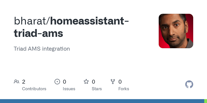

Hey @synergy1281 - I had a similar program while migrating off of Control4 and wrote a driver for the Triad AMS. I’ve only tested it on my Triad 8x8 but if you’d like to give it a go on your 16x16 I can probably get it working for you as well. Check it out.
Just to add thanks here to Bharat, this works fine on my 16x16 Triad AMS24, although I am just getting into the throws of getting my media players and zones showing in HA in a meaningful way, hopefully that will be achievable.
Big thanks to my collaborator Dan (not sure what his username is here on this forum, but he’s dan-s-github (Daniel M) · GitHub on github) for getting the 16x16 and 24x24 support in!

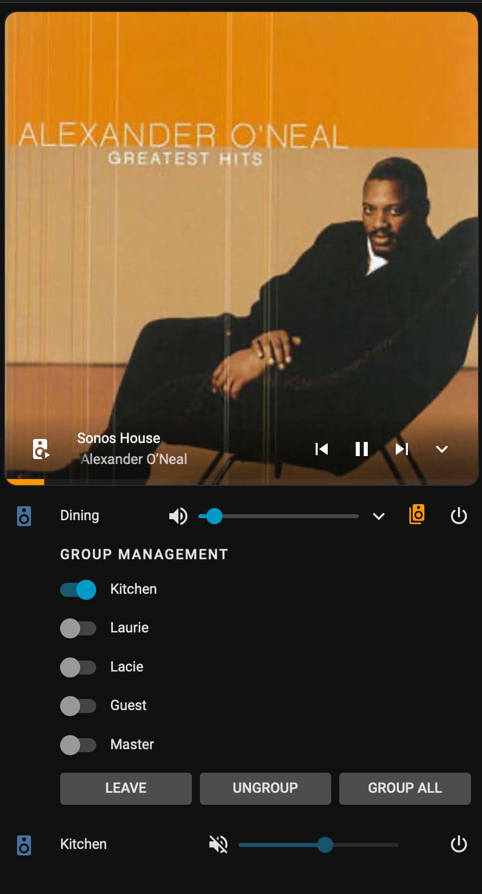

I did at least get the media player in a room to show up like this, with speaker group options that then show the enabled group speaker volume levels so that they can be set independently. I also had this shutting of the zones when removing the speaker group, but still need to do work on removing a zone from the group if that zone is turned off elsewhere (ie from the other zone room).
