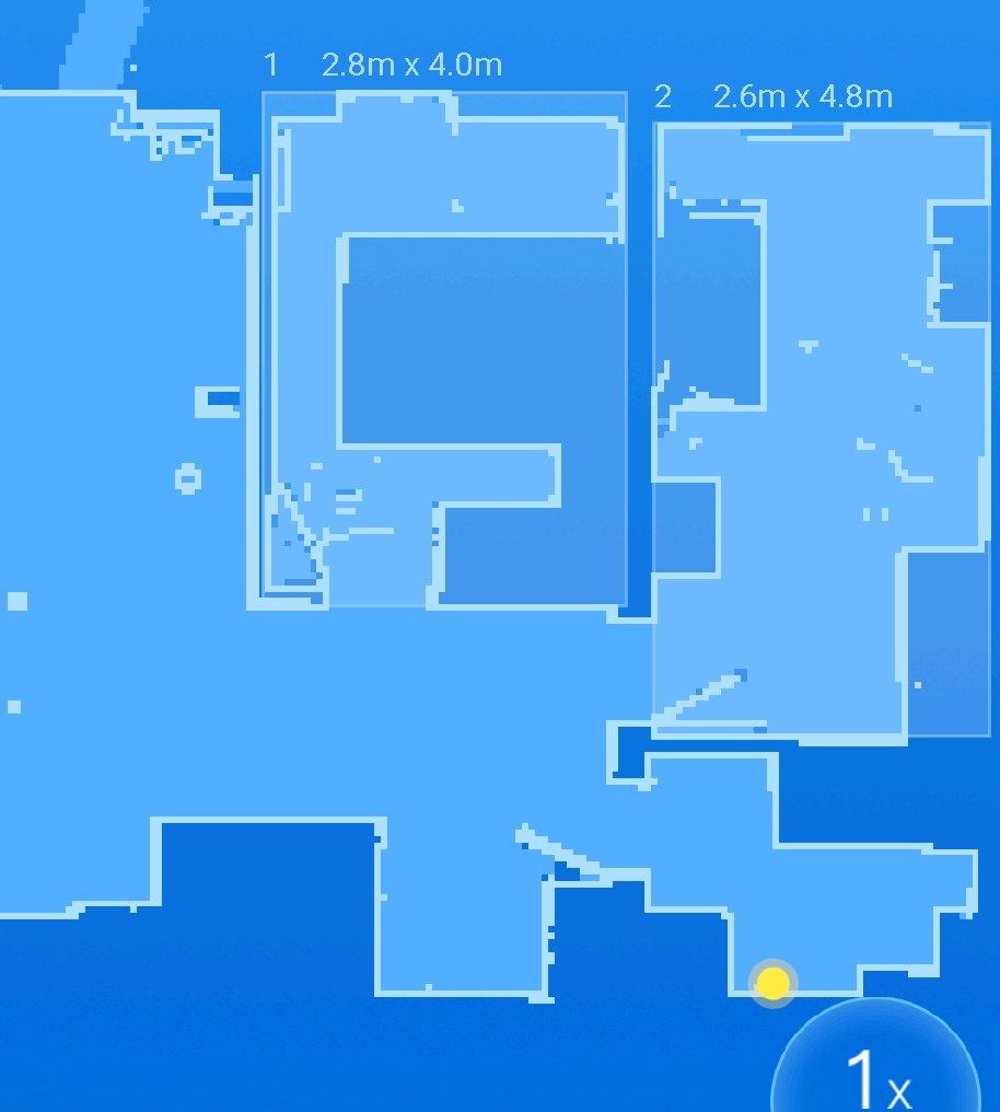

Yes, but as I mentioned this is not exactly I’d like to achieve. As I said, I’d like to use input_booleans not input_select. I made a quick preview what I’d like. Here’s the HA controls:
ha
and a result in Xiaomi’s app after clicking on “CLEAN!” (it’s not working for now, the screen is prepared in the app; it’s only works if I define the zones as static):

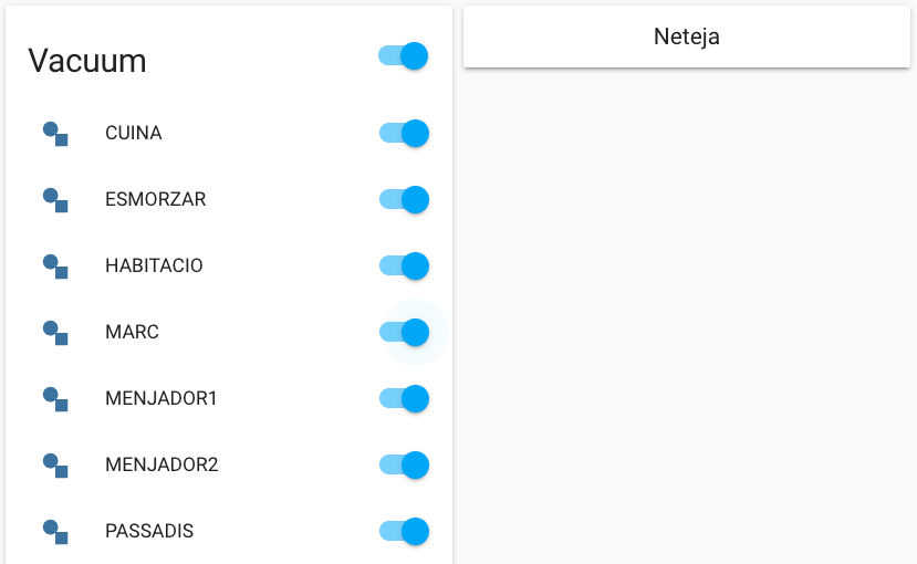

Hi Damian, thanks for your job.
I used your code but I don’t know how to complete the step 6 to combine the button inside the vertical stack. Now I have 2 different cards (first with boleans and 2 with button) but do not works.
Do you know how can i solve-it?
Many thanks
Hi Miquel,
can you please post a screenshot? Moreover, please note that in one of the recent Home Assistant update some services changed names and that might be the reason it is not working for you, for example in xiaomi.py:
was:
hass.services.call(‘vacuum’, ‘xiaomi_clean_zone’, args)
now it is changed to:
hass.services.call(‘xiaomi_miio’, ‘vacuum_clean_zone’, args)
I also changed the scripts.yaml a little to the recommended by HomeAssistant team form (but is is not necessary for now I think):
clean_xiaomi:
  alias: "xiaomi clean action"
  sequence:
    - service: python_script.xiaomi
      data_template:
       input_boolean.livingroom: '{{ states("input_boolean.clean_livingroom") }}'
       input_boolean.bedroom: '{{ states("input_boolean.clean_bedroom") }}'
       input_boolean.room: '{{ states("input_boolean.clean_room") }}'
       input_boolean.bathroom: '{{ states("input_boolean.clean_bathroom") }}'
       input_boolean.hallway: '{{ states("input_boolean.clean_hallway") }}'
       input_number.passes: '{{ states("input_number.xiaomi_passes") | int }}'
       input_select.power: '{{ states("input_select.xiaomi_power") }}'
Hi Damian,
This is a screenshot of my cards.
I changed the xiaomi.py and scripts.yaml but is not working.
I’ll read again all the code looking for changes in last update.
If you have any idea about have to solve it, i’ll apreciate it.
Thanks in advanced.
