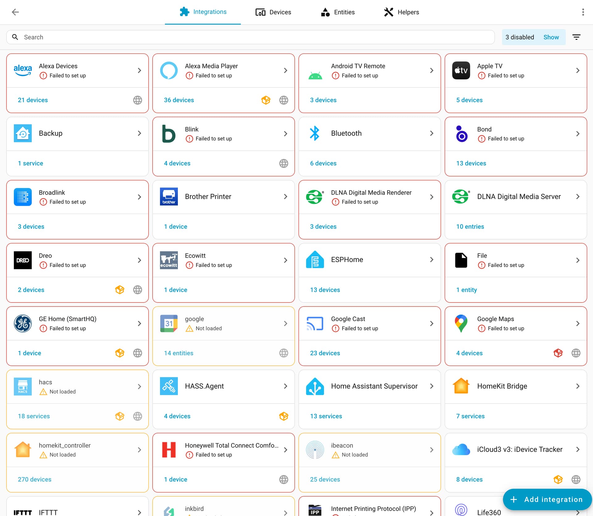

ISSUE / PROBLEM:
For the past several months, whenever I install certain updates (Core, OS, Alexa Media Devices integration, etc.), the system restarts and most of my integrations show “Failed to set up” (see screenshot). The logs contain multiple warnings and errors at that time (see logs).
If I restart the system again—sometimes once, sometimes several times—the integrations eventually initialize and load normally.

SCREENSHOT OF FAILED INTEGRATIONS:
LOGS:

UPDATE — Workaround Found (with help from Claude AI)
After extensive troubleshooting with Claude AI, I found the root cause and a working workaround. Claude was extremely helpful in systematically analyzing my boot logs and identifying the problem.
Root Cause:
The Google Calendar integration takes too long to re-authenticate after a Core update because HA attempts an IPv6 connection first, fails, then falls back to IPv4. This 30-50 second delay pushes the total boot time past HA’s bootstrap stage 2 timeout (~6-7 minutes), causing a cascade of other integration failures.
Workarounds that helped:
  1. Disable IPv6 in HA network settings (Settings → System → Network → end0 → IPv6 → Disabled). This eliminated the IPv6 fallback delay and dramatically reduced Google Calendar’s boot time on normal reboots. Bad boots still occur after major Core updates when all Python modules reload from scratch, but far less frequently.
  2. If you have TP-Link devices, consider assigning them static IPs on your router. This eliminated another source of boot delays.
  3. External watchdog script — since HA’s automation engine itself fails to load during bad boots (making automation-based recovery unreliable), I created a shell script running via the Advanced SSH & Web Terminal add-on that polls the HA REST API every 5 minutes and automatically restarts HA Core if key integrations failed to load. This has been the most reliable recovery mechanism.
