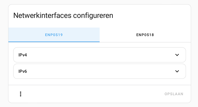

@bogdan see if this is any help
If you use Proxmox you can define more than one interface for your VM. And then in HA it will be displayed like this.
@FriedCheese thank you, I have tried that already, but for me it is a little different, I have both Connected. I think something is disabling the traffic trough the second lan and not the port itself. I will check it further.
@doubleUS yes, it is the same for a PC, I can see all the NIC’s there. I have 3 entries there, double port network card and one onboard lan port. But configuring that will not change anything.
