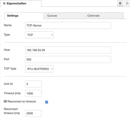

Not shure if I’m right here but since I’m new to HA (switched from OH) I won’t open a new topic already.
I’ve a similar setup exept my energy-meters (6 SDM120 und one SDM630) are connected thue a single RTU (RS485) to TCP Device.
So if I try to do this setup:
modbus:
  - name: SDM630
    type: rtuovertcp
    host: 192.168.33.28
    port: 502
    sensors:
      - name: Phase 1 voltage
        unique_id: total_l1_voltage
        unit_of_measurement: V
        address: 0
        state_class: measurement
        device_class: voltage
        slave: 2
        count: 2
        precision: 2
        scan_interval : 60
        input_type: input
        data_type: float32
I don’t get any answer.
Same in RED-Node works fine:
Has someone any ideea what’s wrong with my modbus-config? Any hint?
