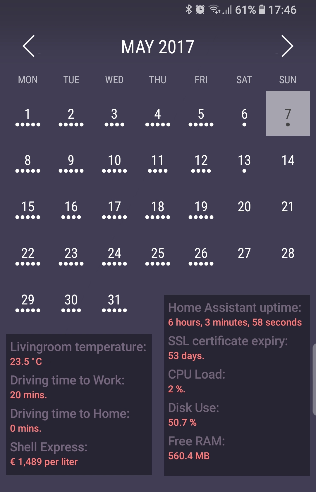

Pfffff I see what I did wrong: on some sensors I put the word “sensor” twice…
description: "{{ states.sensor.sensor.ssl_cert_expiry.state }} days."
description: "{{ states.sensor.sensor.disk_use_home.state }} %"
description: "{{ states.sensor.sensor.ram_free.state }} MB"
Working like a charm now:
