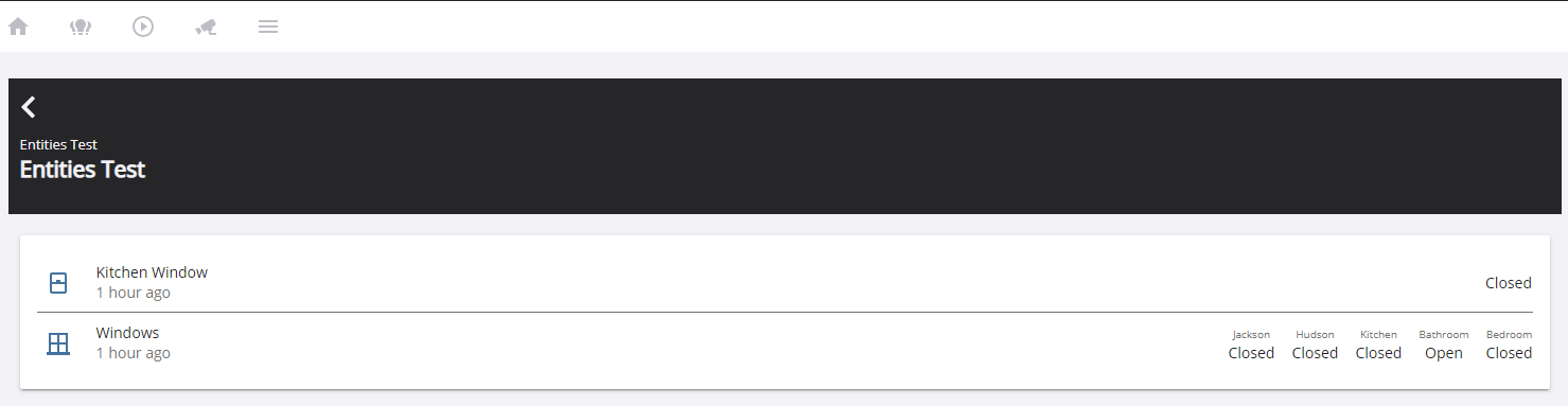

Managed to give it a test try this — I’m using panel:true
- type: entities
    - entity: binary_sensor.door_window_sensor_158d0001e73af4
      type: custom:multiple-entity-row
      secondary_info: last-changed
    - type: divider
    - entity: group.windows
      icon: mdi:window-closed-variant
      show_state: false
      state_color: true
        - entity: binary_sensor.door_window_sensor_158d0001e73a73
        - entity: binary_sensor.door_window_sensor_158d0001e73aad
        - entity: binary_sensor.door_window_sensor_158d0001e74875
        - entity: binary_sensor.door_window_sensor_158d0001f36741
