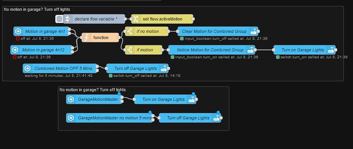

Probably the easiest way to handle this… make a “group” with HA helpers… Example - I have 2 motion sensors in my garage… I made a group - MasterGarageMotion — then use that ‘helper’ entity in your nodered flow.
And to be honest… I originally had nodered watch both sensors… if one changed, it stored the state as a flow variable… soo if 1 motion sensor saw me, that variable would be 1… but if both saw me… it would be 2… the rest of the flow would wait until that variable was 0 for X amount of time… however groups makes it really simple
Here’s the difference

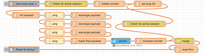

Here is a little flow where I use the merge node.
Its just a ping function, so correct the set ping list node with your names and IPs and it should work.
The flow sometimes fail if HA is not ready and due to the way it is constructed it will not restart again unless a variable is cleared, but if it is cleared too soon, then the flow will not finish correctly and some IPs might then not get pinged.
The merge node handles this because as long as the script runs the merge node will get new messages in and therefore not anything to the reset flow node.
If the flow fails, then there no new messages to the merge node and after 300 seconds it will send a message to the reset flow node and thereby make a restart of the flow possible.

Here’s the json for the cleaner setup – I deleted the bigger flow last night after I posted, soo here’s hoping you want the easy one lol
[{"id":"185c4d3807634569","type":"tab","label":"Flow 1","disabled":false,"info":"","env":[]},{"id":"b0c5eeb462a1cc96","type":"group","z":"185c4d3807634569","name":"No motion in garage? Turn off lights","style":{"label":true},"nodes":["4a6ff6312d5bdc90","439fc6d0c7ee4959","1556bd57caba728e","c81277d5ea5e4f73"],"x":214,"y":119,"w":552,"h":142},{"id":"4a6ff6312d5bdc90","type":"server-state-changed","z":"185c4d3807634569","g":"b0c5eeb462a1cc96","name":"GarageMotionMaster","server":"da3b2d1e.ad751","version":4,"exposeToHomeAssistant":false,"haConfig":[{"property":"name","value":""},{"property":"icon","value":""}],"entityidfilter":"binary_sensor.garagemotionmaster","entityidfiltertype":"exact","outputinitially":false,"state_type":"str","haltifstate":"on","halt_if_type":"str","halt_if_compare":"is","outputs":2,"output_only_on_state_change":true,"for":"0","forType":"num","forUnits":"seconds","ignorePrevStateNull":false,"ignorePrevStateUnknown":false,"ignorePrevStateUnavailable":false,"ignoreCurrentStateUnknown":false,"ignoreCurrentStateUnavailable":false,"outputProperties":[{"property":"payload","propertyType":"msg","value":"","valueType":"entityState"},{"property":"data","propertyType":"msg","value":"","valueType":"eventData"},{"property":"topic","propertyType":"msg","value":"","valueType":"triggerId"}],"x":330,"y":160,"wires":[["1556bd57caba728e"],[]]},{"id":"439fc6d0c7ee4959","type":"api-call-service","z":"185c4d3807634569","g":"b0c5eeb462a1cc96","name":"Turn off Garage Lights","server":"da3b2d1e.ad751","version":5,"debugenabled":false,"domain":"switch","service":"turn_off","areaId":[],"deviceId":[],"entityId":["switch.garage_main_lights_switch"],"data":"","dataType":"jsonata","mergeContext":"","mustacheAltTags":false,"outputProperties":[],"queue":"none","x":640,"y":220,"wires":[[]]},{"id":"1556bd57caba728e","type":"api-call-service","z":"185c4d3807634569","g":"b0c5eeb462a1cc96","name":"Turn on Garage Lights","server":"da3b2d1e.ad751","version":5,"debugenabled":false,"domain":"switch","service":"turn_on","areaId":[],"deviceId":[],"entityId":["switch.garage_main_lights_switch"],"data":"","dataType":"jsonata","mergeContext":"","mustacheAltTags":false,"outputProperties":[],"queue":"none","x":560,"y":160,"wires":[[]]},{"id":"c81277d5ea5e4f73","type":"server-state-changed","z":"185c4d3807634569","g":"b0c5eeb462a1cc96","name":"GarageMotionMaster no motion 5 mins","server":"da3b2d1e.ad751","version":4,"exposeToHomeAssistant":false,"haConfig":[{"property":"name","value":""},{"property":"icon","value":""}],"entityidfilter":"binary_sensor.garagemotionmaster","entityidfiltertype":"exact","outputinitially":false,"state_type":"str","haltifstate":"off","halt_if_type":"str","halt_if_compare":"is","outputs":2,"output_only_on_state_change":true,"for":"5","forType":"num","forUnits":"minutes","ignorePrevStateNull":false,"ignorePrevStateUnknown":false,"ignorePrevStateUnavailable":false,"ignoreCurrentStateUnknown":false,"ignoreCurrentStateUnavailable":false,"outputProperties":[{"property":"payload","propertyType":"msg","value":"","valueType":"entityState"},{"property":"data","propertyType":"msg","value":"","valueType":"eventData"},{"property":"topic","propertyType":"msg","value":"","valueType":"triggerId"}],"x":380,"y":220,"wires":[["439fc6d0c7ee4959"],[]]},{"id":"da3b2d1e.ad751","type":"server","name":"Home Assistant","version":2,"addon":true,"rejectUnauthorizedCerts":true,"ha_boolean":"y|yes|true|on|home|open","connectionDelay":true,"cacheJson":true,"heartbeat":false,"heartbeatInterval":30}]
That turns the lights on when it sees movement, and turns them off after 5 minutes of no activity.
You can always add more, like maybe check for brightness before turning the lights on (if your sensors support luminance)
and again, the MasterGarageMotion entity is made via HA helpers - Group

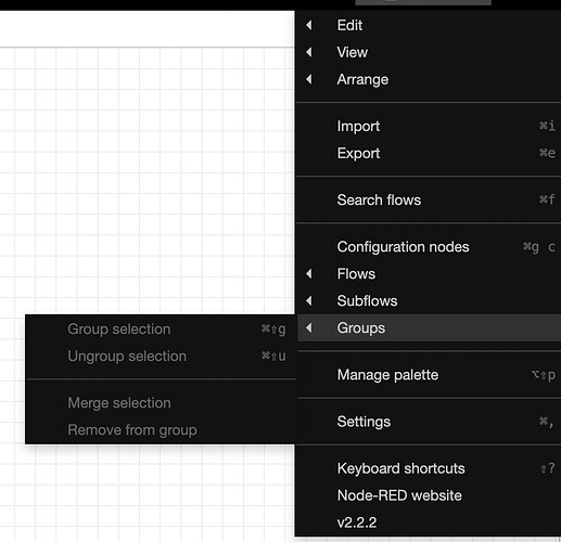

Silly Question? I love what you have done with creating the grey square box around the steps. Is there a trick to making that bigger?

Found it. Hightlight all the nodes you want and then select Group Selection. It draws the box around it.
Have to ungroup and then group again if my nodes grow. small pain point. Much prefer having this boxed off to make it easier to know whats what
That is not necessary, select the group and the additional nodes by holding ctrl. The drop down you show above, merge selection will be available.
