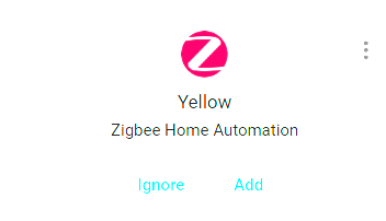

Finally my yellow is saying it wants to install the built in Zigbee
  • Will that use ZHA and so not work?

oh I now think the zigbee unreliable is bacuase I had two networks ZHA saw them both and offered to connect them both - which is unsupported
I now have one ZHA and it has been fine for a day
