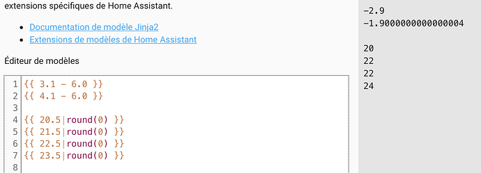

Ok, my bad for the precision issue, in C, I got:
4.100000 - 6.000000 = -1.900000
4.0999999999999996 - 6.0000000000000000 = -1.9000000000000004 == -1.8999999999999999 ? 0
The good think is that printf rounds the result, and the comparison is correct, so it’s transparent.
And thanks for the round() link, the default “round-to-even” was my main surprise, I will use the downward/ceil one, which is more coherent with C math lib:
round(20.5000000000000000) = 21.0000000000000000
round(21.5000000000000000) = 22.0000000000000000
round(22.5000000000000000) = 23.0000000000000000
