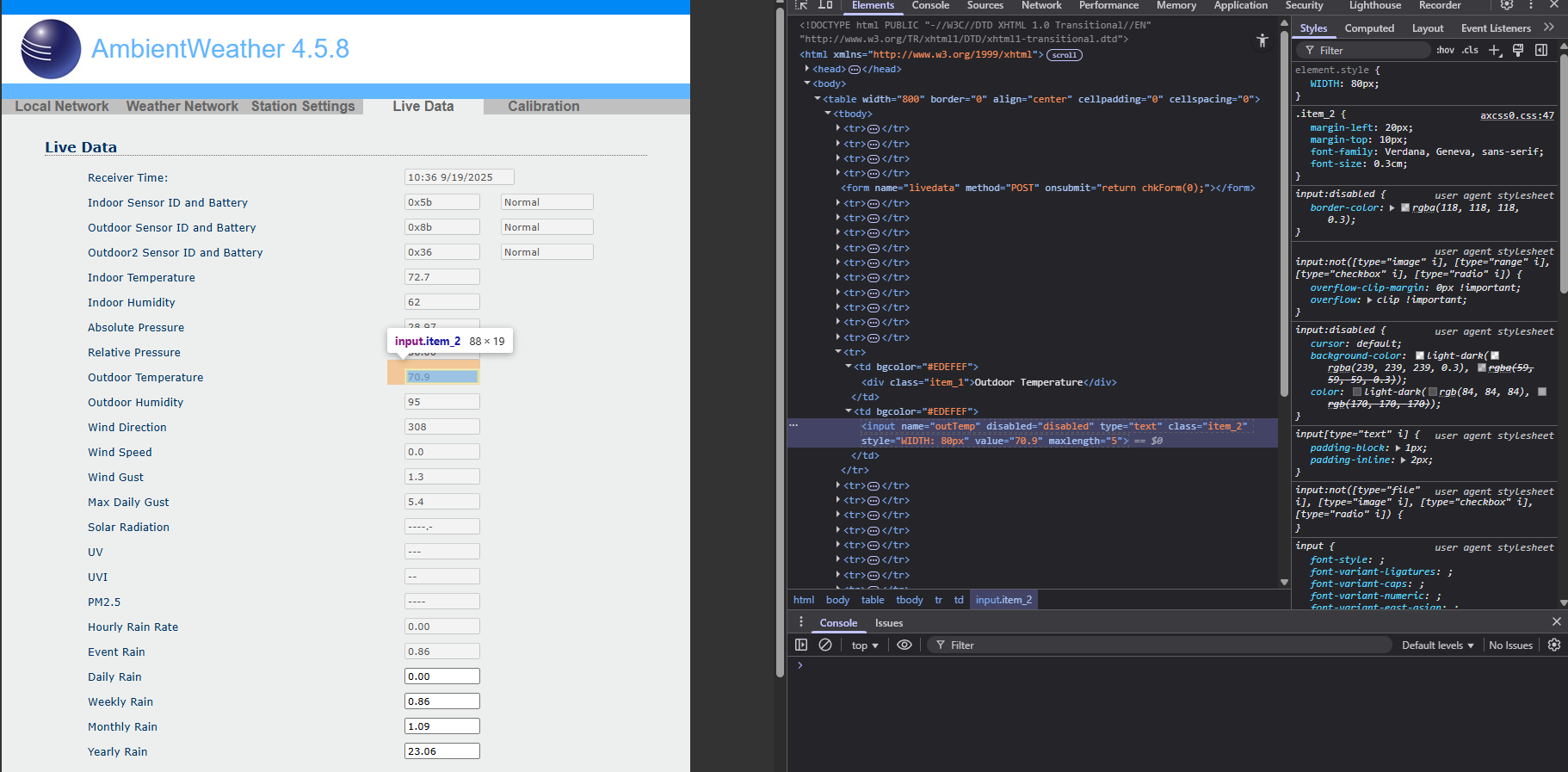

I’m trying to use the multiscrape custom integration to pull in weather data from my weather station that hosts a local webpage with the info I want (no login or anything). Seems to be about as basic of a webpage as you can get, yet I’m not having any luck. Here’s a screenshot of the page with a value I’m trying to grab highlighted:
When I copy selector for that value, I get:
body > table > tbody > tr:nth-child(16) > td:nth-child(2) > input
And here’s my resulting YAML:

I’ve tried with the above, as well as removing ‘tbody’ and ultimately even ‘body’, ‘table’ and ‘input’ with no luck; the sensor is always ‘unavailable’ (I will mention that with one or more of the many variations I tried, it would periodically NOT be unavailable, but also didn’t have a state). Is there something super-obvious I’m missing (I’m sure there is)? Obviously I can’t actually share the link since it’s a local webpage, but if more info is needed just ask.

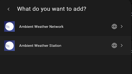

I don’t have advice on the web scrape but there is an ambient weather integration.
Yeah, I used that years ago but it’s both cloud-based and also obviously requires that you’re sending your station data to them, which I’m not. I’ve come across other potential local options in the past, but they’re all for newer/different weather stations than what I have and thus don’t work.
Ambient Weather Local works great!
Unfortunately my weather station isn’t supported, it’s too old.
WS-0900-IP
I think that was one of (or THE) other local option(s) that I checked out in the past.

I get the following error: Unable to scrape data: Could not find a tag for given selector
The log file includes the data I’m after, which would seem to confirm that it should be possible.
I guess that means you need to get your selector right?
