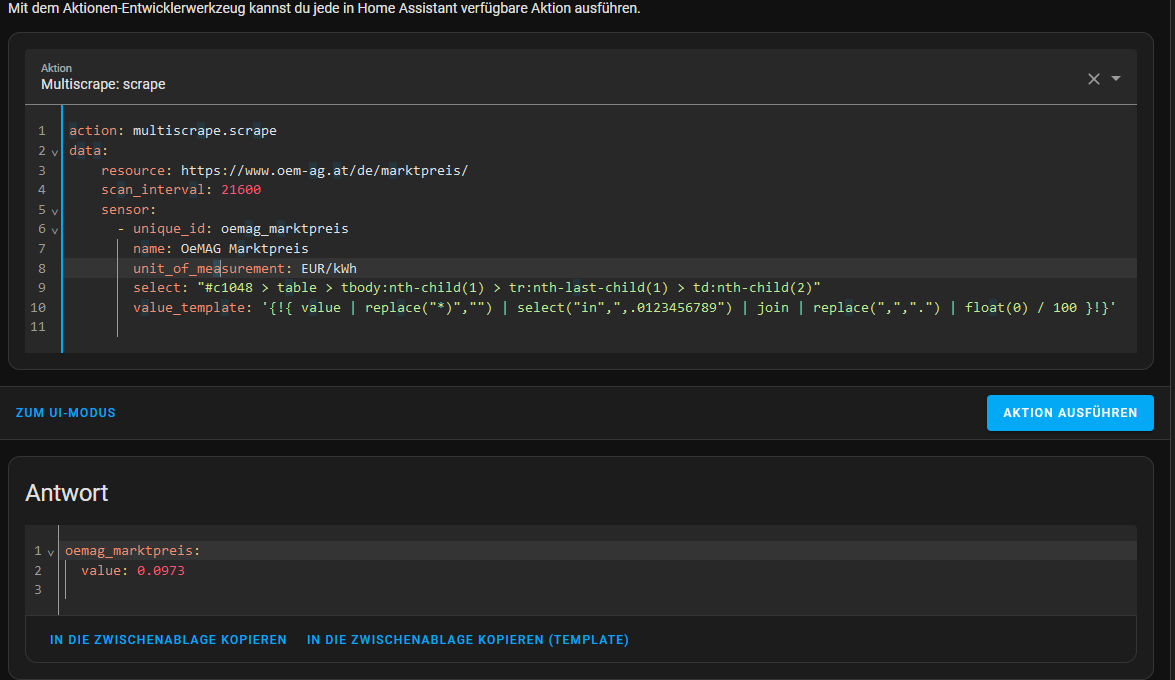

Hi all,
the Website changed a little bit and so I tried to correct the multiscrape entry in my yaml.
Before the value on the site to be read was within <strong> -tag. Now this is removed and *) is inserted after the energy price.
So i tried to replace this to nothing with | replace("*)","") right after the value-variable
  - name: HA scraper for oem-ag
    resource: https://www.oem-ag.at/de/marktpreis/
    scan_interval: 21600
    sensor:
      - unique_id: oemag_marktpreis
        name: OeMAG Marktpreis
        unit_of_measurement: EUR/kWh
        select: "#c1048 > table > tbody:nth-child(1) > tr:nth-last-child(1) > td:nth-child(2)"
        value_template: '{{ value | replace("*)","") | select("in",",.0123456789") | join | replace(",",".") | float(0) / 100 }}'
In developer Tools all is fine … (BTW: {{ becomes {!{ in developer tools read the multiscrape documentation)
… but not in yaml, and I can’t find the error. The sensor becomes unavailable.
Can someone pint me to the mistake, pls?
