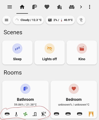

Hi!, I saw your mushroom customization in another topic and I really liked it, do you mind to share your button cards (Despacho) / mushroom
That’s unfortunately not Mushroom, but Minimalist UI, Room Card
Can you share your yaml for those room cards? I couldn’t find it in previous post but maybe my mobile search is limited. Thank you
