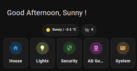

Try something like this:
type: custom:mod-card
card:
  type: custom:mushroom-title-card
  title: Hello, {{ user }} !
  subtitle: test
card_mod:
  style:
    mushroom-title-card$: |
      .title {
        font-size: 18px !important;
        font-weight: 600 !important;
      .subtitle {
        #do something with subtitle
      ha-card {
        background: red;
mush-card
type: vertical-stack
cards:
  - type: custom:mushroom-title-card
    title: |-
      {% set time = now().hour %}
      {% if (time >= 21) %}
        Good Night, {{user}} !
      {% elif (time >= 17) %}
        Good Evening, {{user}} !
      {% elif (time >= 12) %}
        Good Afternoon, {{user}} !
      {% elif (time >= 6) %}
        Good Morning, {{user}} !
      {% else %}
        Hello, {{user}} !
      {% endif %}
    title_tap_action:
      action: none
    subtitle_tap_action:
      action: none
  - type: custom:mushroom-chips-card
    chips:
      - type: weather
        entity: weather.ecobee
        double_tap_action:
          action: none
        show_conditions: true
        show_temperature: true
        tap_action:
          action: more-info
        hold_action:
          action: none
      - type: template
        double_tap_action:
          action: none
        entity: sensor.lights_on
        icon: |-
          {% if (states('sensor.lights_on') | int >= 1) %} mdi:lightbulb-group
          {% else %} mdi:lightbulb-group-off
          {% endif %}
        icon_color: |-
          {% if (states('sensor.lights_on') | int >= 1) %} amber
          {% else %} grey
          {% endif %}
        content: |-
          {% if (states('sensor.lights_on') | int == 0) %}{0}
          {% else %} {{ states('sensor.lights_on') | int }}
          {% endif %}
        tap_action:
          action: none
        hold_action:
          action: none
    alignment: center
  - type: horizontal-stack
    cards:
        primary: House
        secondary: ''
        icon: mdi:home
        icon_color: blue
        layout: vertical
        fill_container: false
        tap_action:
          action: navigate
          navigation_path: /mobile-view/home
        hold_action:
          action: none
        double_tap_action:
          action: none
        primary: Lights
        secondary: ''
        icon: mdi:lightbulb
        layout: vertical
        icon_color: '#FFFF99'
        tap_action:
          action: navigate
          navigation_path: lights
        primary: Security
        secondary: ''
        icon: mdi:security
        icon_color: green
        layout: vertical
        hold_action:
          action: none
        double_tap_action:
          action: none
        tap_action:
          action: navigate
          navigation_path: security
        primary: AD Guard
        secondary: ''
        icon: mdi:check-network
        icon_color: '#FF66FF'
        layout: vertical
        hold_action:
          action: none
        double_tap_action:
          action: none
        tap_action:
          action: navigate
          navigation_path: ad-guard
        primary: System
        secondary: ''
        icon: mdi:raspberry-pi
        icon_color: '#FFB266'
        hold_action:
          action: none
        double_tap_action:
          action: none
        tap_action:
          action: navigate
          navigation_path: /mobile-view/hardware
        layout: vertical
    card_mod:
      style: |
        mushroom-template-card {
          border: none;
          box-shadow: none;
Can someone help me with the code I want to remove the border for just the mushroom-template-cards (i added the card-mod but its not working, it does work if enter it under individual template-card but that would mean I have repeat the same code over and over again which is pointless)
and I want to appear as pills if possible to reduce the dead space around the cards
If possible I would also like to have the 2 chips sizes to be same, i.e whatever the size of the weather chip is make the same size for my template chip

How can I change the color of the symbol inside of the circle?
Screenshot 2023-03-16 at 08.46.58
