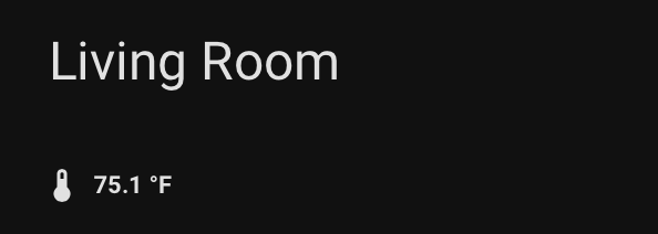

How can I remove the bottom gap in Title card?Screen Shot 2022-07-02 at 10.29.50 AM
I believe it’s configurable with a theme. Check your inspector.
I still can’t figure this one out. Not sure what’s wrong with it.
You can’t use card-mod like that. You can’t mix the text and YAML shadow-rooting, you’re going to have to use YAML only. Also have you considered shortening the names, eg by removing the ā€œlightsā€ at the end?
I still strongly recommend shortening your names. It’ll make your UI easier to parse. However:
