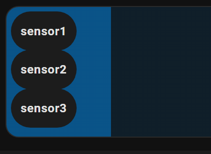

I use mushroom-chips-card and mushroom-template-card how can I reduce the height and width of the space used by these cards, I use a transparent background and I want to reduce the distance between the cards and not to increase the outer border
I think I need to put some property here, but which one ?
card_mod:
style: |
ha-card {
Please provide your card code…

I need to remove the spaces between sensor1, sensor2, sensor3.
You have some mod settings that may or may not be neceesary, but this will handle your inquiry

I’m sorry, but the gaps haven’t gone anywhere, just widened at the top and bottom.
Well the screenshot I shared isn’t photoshopped…lol
What card mod version are you using? If it is v3.5.0 please install v3.4.4
I see the same thing as on your screenshot, the gaps have only increased at the top and bottom, but between the inscriptions remain the same. here on my screenshot I show it with arrows.
I use v3.4.4 card mod
The gaps between the sensors HAS changed. I’d suggest changing margin-top: -1px; and see the difference before stating nothing changed.
This will remove the gaps at the top and bottom

My alignment
Your alignment
