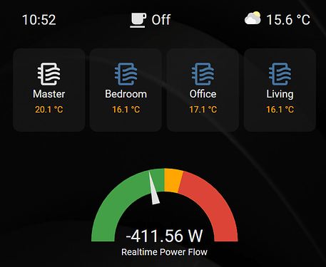

I’m using the mushroom chips on a dashboard and I’m trying to conditionally display one of the chips based on time of the day. e.g. Show the espresso chip between 6am and 10am.
I’ve gotten stuck trying to add a time condition and I’m not sure what I’m doing wrong.

I’ve tried many different variations, with the time in quotes, no quotes, but still can’t figure it out.
But if I make it conditional based on an existing entity (light state = on), then it works.

Hey @NathanCu thanks so much for your guidance!
Creating a template sensor in my configuration.yaml works:
  - platform: template
    sensors:
      morning_time:
        friendly_name: "Morning Time"
        value_template: "{{ 6 <= now().hour < 10 }}"
And revised styling code:

I am still getting my head around all these configurations and customisations and trying to figure out where things should be defined.
