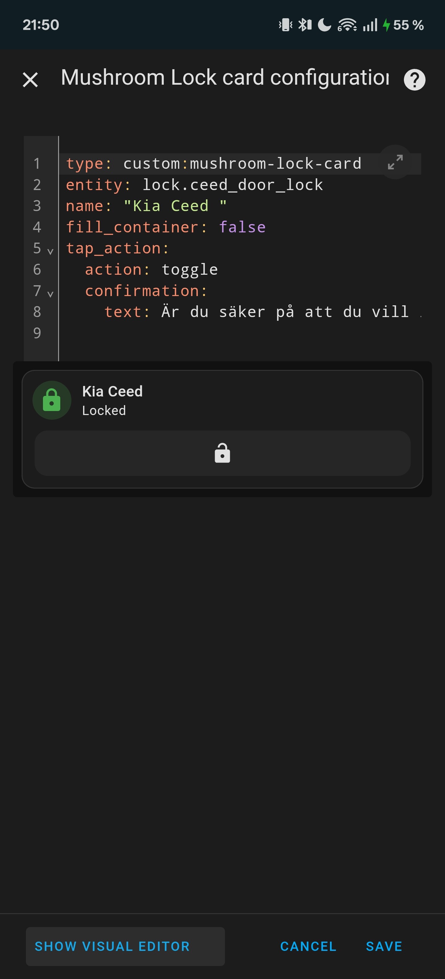

What about the button card? I have this;
I do get the confirmation popup when I tap the card but not on the actual button itself.
type: custom:mushroom-lock-card
entity: lock.ceed_door_lock
name: "Kia Ceed "
fill_container: false
tap_action:
  action: toggle
  confirmation:
    text: Är du säker på att du vill låsa/låsa upp?
Tjena.
For this add the icon_tap_action entry:
icon_tap_action:
  action: toggle
  confirmation:
