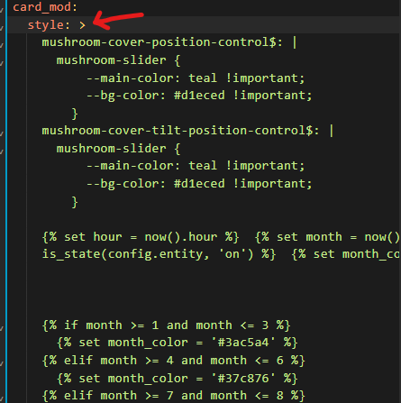

I have tried those, they dont work because of “style: >” instead of just “style:”, when im removing the > the whole code stops working, so im just wondering if its possible to implent the change bar color code differently?

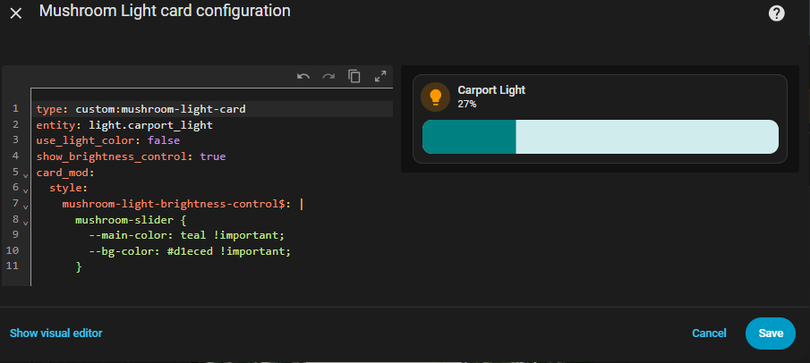

This seem to work for me. Maybe start with a basic light first.
type: custom:mushroom-light-card
entity: light.carport_light
use_light_color: false
show_brightness_control: true
card_mod:
  style:
    mushroom-light-brightness-control$: |
      mushroom-slider {
        --main-color: teal !important;
        --bg-color: #d1eced !important;

I believe this is what you are trying to achieve or at least a starting point.
card_mod:
  style: |
    {% set hour = now().hour %}
    {% set month = now().month %}
    {% set is_on = is_state(config.entity, 'on') %}
    {% set month_color = '#5F5F55' if month < 1 else '#3ac5a4' if month <= 3 else '#37c876' if month <= 6 else '#07d049' if month <= 8 else '#de8121' if month <= 10 else '#b1d2f1' %}
    ha-state-icon {
      {% if is_on %}
        animation: wobbling 0.8s linear infinite alternate;
        color: {{ month_color }};
      {% else %}
        color: #495a59;
      {% endif %}
    @keyframes wobbling {
      0% {transform: rotate(-15deg);}
      100% {transform: rotate(15deg);}
    ha-card {
      background: {{ 'transparent' if 6 <= hour < 20 else '#181915' }} !important;
      border: 2px solid {{ month_color }};
    mushroom-light-brightness-control {
     --slider-color: lime !important;
     --slider-bg-color: blue !important;
Wow :face_with_peeking_eye: so easy… Im been trying to solve this for two days, thanks a LOT
