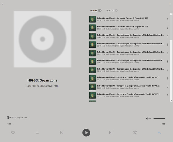

  3. the organ zone player shows up correctly as a renderer in MA, and I can edit its settings, including disabling volume normalization . When I start playing back media, i don’t get an error, but I also don’t get any sound, and the transport stays at 0:00 .
The good news is MA is definitely communicating with JRiver over DLNA .
Here is the MA side :

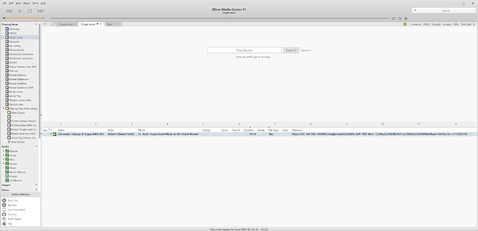

And the JRiver side :
Notice how they are both showing the same media/track.
I believe there may be some settings I’m missing on either the JRiver or MA side, and there could be a bug or two that needing fixing on either or both sides. DLNA is apparently a fairly loosely defined protocol, and I have seen many problems between players, controllers and servers.
