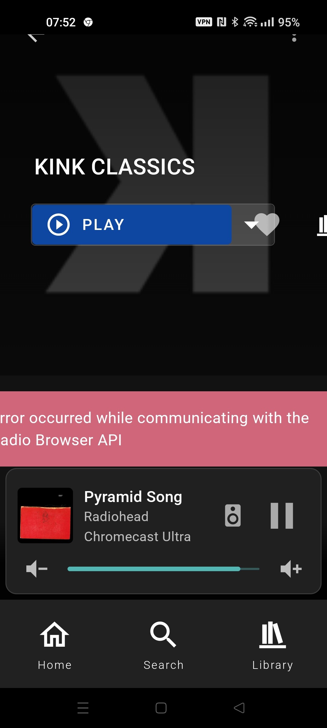

I can’t seem to get Radio Browser provider te work anymore…
Tried restarting my container, reload the provider, sync the provider, but nothing works.
When I open a random Radio, it shows an error; “Error occurred while communicating with the Radio Browser API”.
I’m always on latest MA version (auto update).

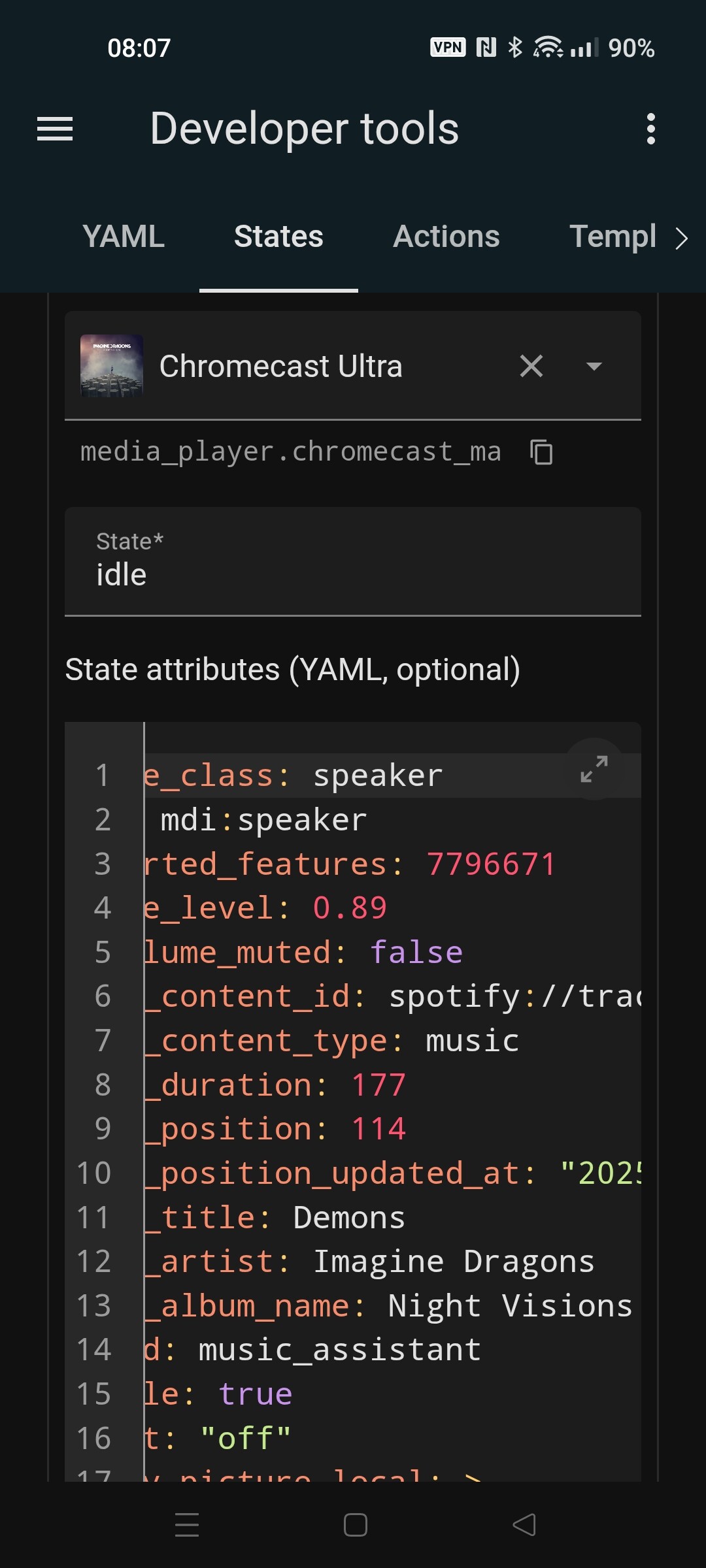

Secondly, the MA integration in HA does something strange as well. The media player in developer options in HA shows that it is playing, but status of the player remains on “idle”.
In MA the player is just playing. And yes, it is also actually playing music :crazy_face:
Same here :disappointed:
