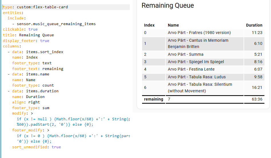

I’m curious how you converted the response into a template sensor. I’m hoping to create a viewable list on my ESP32 Display, but text helpers aren’t an option due to the character limit.
Not sure what your skill level is and I don’t want to highjack this thread so… in short, entity/sensor attributes can hold a metric shit ton more than 255 characters.
