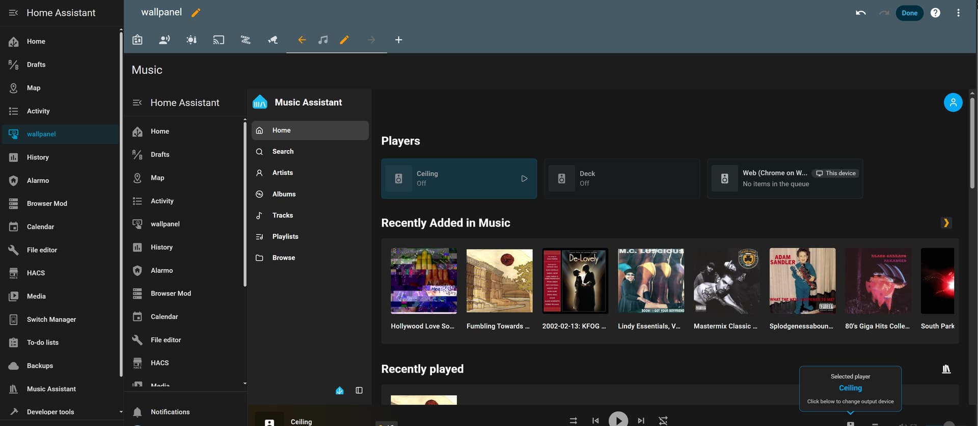

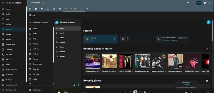

Hi all, I have HA configured on https://mydomain.com:8123. I’m hosting my own DNS and I’m using certificates via Let’s Encrypt. I would like to now embed MA in a regular dashboard view but it appears the MA web server is only available over http and therefore the webpage card approach doesn’t work. Embedding https://mydomain.com:8123/d5369777_music_assistant does work with the webpage card but duplicates the HA sidebar, header etc.

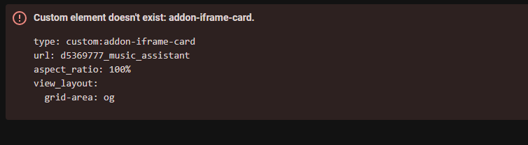

use this card: GitHub - lovelylain/ha-addon-iframe-card: HA webpage card with addon ingress support.
url: d5369777_music_assistant

FYI… make use to use url: d5369777_music_assistant
not url: /d5369777_music_assistant
the extra / will replicate the main Home Assistant side-bar menu (left side menu)…
