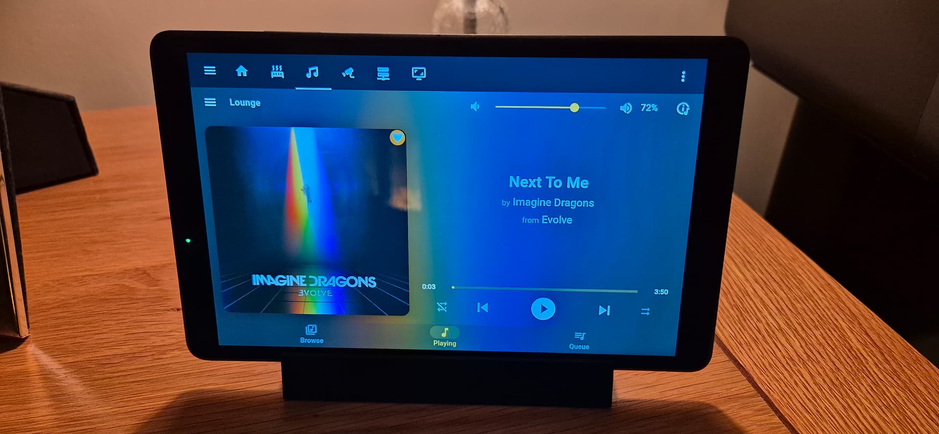

Yes you can do this. I use a full screen page on my HA for LMS control using the Material skin. I keep some navigation icons along the top bar which makes it easy to navigate back to HA dashboards.
You can also do cool stuff like navigate to the LMS page when the player starts playing (if controlled from another device). Works very well for a room based panel.
