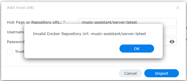

Am I failing to enter the correct URL in a wrong syntax?
Or is entering these URLs into the Synology’s - Container Manager - Action-Enter from URL menu the wrong way?

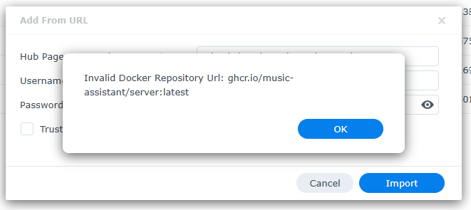

You can try with a full url like:
https://ghcr.io/music-assistant/server:latest
Or you have a dns problem.
Thank you Ettore @AutoDIY for the quick reply.
I had tried adding https:// before - not working/ same error message.
I am familiar with creating a container from an image. Done that many times, incl. the mappings, etc. All info is in the docker compose file, which I read and manually transfer into the Synology screens that your link shows.
I just fail locating music assistant’s docker container itself.
  1. It does not show in Synology’s registry. What does that precisely mean? Did the maintainers not register or upload it there?

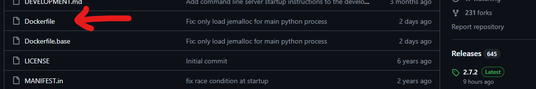

  2. Can’t I use the docker file here? GitHub - music-assistant/server: Music Assistant is a free, opensource Media library manager that connects to your streaming services and a wide range of connected speakers. The server is the beating heart, the core of Music Assistant and must run on an always-on device like a Raspberry Pi, a NAS or an Intel NUC or alike.

What do you want to do with that file?
You may want to use a docker compose file, like the original that you find in docs:
