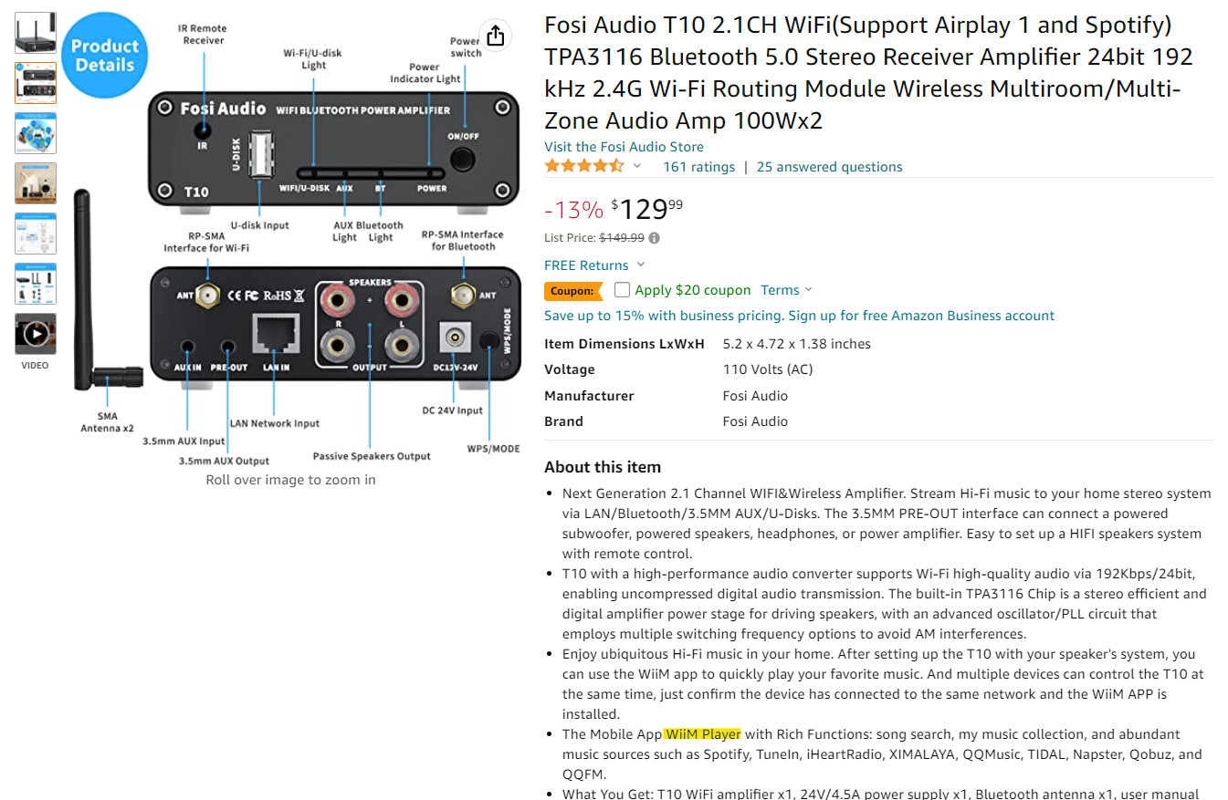

have anyone tried this Amp + WiiM device?
I have the 2.1 version. In my office, it powers 2 Klipsch bookshelfs and a sub. I would not call it audiophile quality, but for the 80 square foot office it fills the room nicely.
I source it from a media server, so I havent tried it with WiiM.
