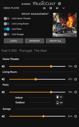

@CharlesGitHib quick question for you. I love your design and used it as inspiration for my MusicCast Group Control card. How did you get the little Yamaha logo’s next to the room names? I really like the look of that a lot. Here’s my current card layout:
@staceydodds love the card, would appreciate if you could shave the entire YAML?
Sorry for the late reply. Haven’t been here in a while. Here’s my updated looking card:
And here’s the code for the card:
type: custom:button-card

nice work, very much appreciate your sharing!
