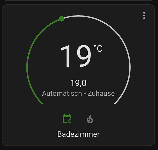

I just installed your custom integration and it seems to work properly. I’m using it with a Schluter Ditra Heat (customerId = 3).
However, pressing one of the two buttons in the Lovelace layout gives this error message:
climate/set_hvac_mode. OJMicrolineThermostat.async_set_hvac_mode() got an unexpected keyword argument 'hvac_mode'
I will give further feedback when I have things to add.
See also the two attached screenshots! :slight_smile:
The set hvac mode hasnt really been implemented (yet), it just sets the preset to schedule I think. I dont think its possible to tell the thermostat to ‘heat’ or ‘auto’. It just switches on/off based on the temperature?
Im close to v1 btw, so dont give up hope yet! :wink:
